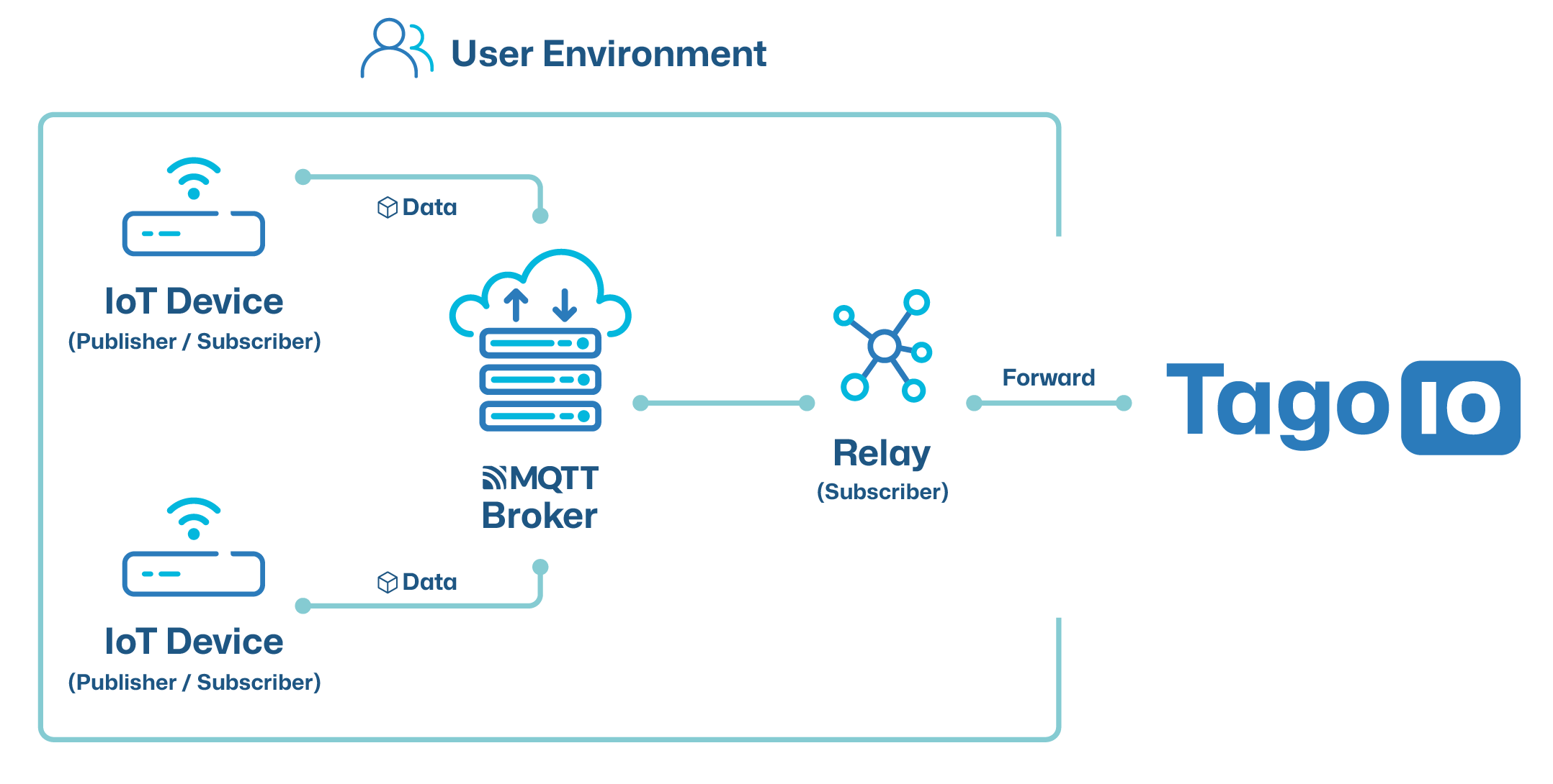

We are thrilled to announce the launch of our newest feature, the TagoIO MQTT Relay, which is available right now. This open-source and highly scalable software will enable you to seamlessly connect your preferred MQTT Broker (e.g., HIVEMQ, EMQX, etc.) to the TagoIO platform.
What is TagoIO MQTT Relay?
The TagoIO MQTT Relay acts as a bridge between your MQTT Broker and the TagoIO platform, facilitating smooth integration and data flow. By subscribing to predefined topics on your MQTT Broker, the MQTT Relay ensures that incoming data is redirected to your TagoIO Devices.
