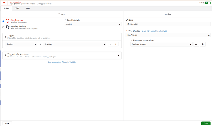

2 - Create an Action to trigger the Analysis when devices receive an update at the location variable.
In this action, you will choose which device do you want to trigger the analysis, in my case I didn’t put a condition, so every time that I receive an update of the location, the analysis will run.
That’s it, with these steps you can build receive notifications every time a device enters a Geofence. This code can be adapted to notify when the device is not inside of any geofence as well, you just need to include a new notification.send before the function startAnalysis finish.

Considering my devices send data every few seconds whenever they are moved, I would like to avoid having to run a lot of analysis, I would like to lock the action to only run the analysis once when it detects the device to be inside the geofence and unlock it when it detects it to be outside but also only run the analysis once and lock again until the device goes inside.
What is the proper way to implement an action lock with this example?
Would this require 2 actions per device in order to do this, one for inside the geofence and one for outside?
What variable would be required to detect this outside of the analysis? Could I potentially use a geofence event to consider whether the device is in or out? I have considered using lat and long to do this, but this would be very rigid considering I would need the change the conditions every time I might want to move the geofence.
