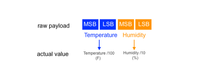

Each device sends data using their own specific format, usually a hexadecimal raw payload like 0x0F55028A, this hexadecimal is great for devices, but for end users, raw payloads should be converted to actual variables like temperature or humidity .
In our LoRaWAN Payload parser example, we will use a four byte hexadecimal payload. The first two bytes represent the values for temperature, and the last two are the values for humidity. In this case, the temperature and humidity must be multiplied by 100 to get the correct value.
