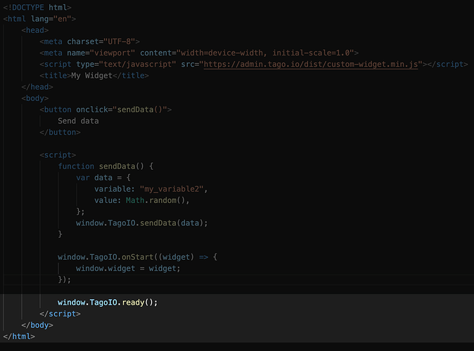

The screenshot below is the smallest working example of a Custom widget.
Don’t worry if you find this challenging, we’ll go step-by-step and understand the code together. The code in the screenshot above will produce the following result:

Let’s walk this through step-by-step and understand our code.
These first two lines are just setting up our structure, telling the browser that the language is english and that the content of this file is html.
Here we define the configuration for the html file. There are two <meta> tags, the first one allows the use of accents in your texts (e.g. é, á, í), and the second one allows your widget to be correctly visualized in a mobile browser.
[IMPORTANT] The <script> tag tells the browser that this html file will use an external script; in this case, the external script is the TagoIO toolkit. In summary, this toolkit allows you to connect and communicate from your widget to TagoIO.
The <title> is used by the browser in case the widget goes fullscreen. This does NOT define the title of widget in the dashboard.
Here we define the initial <body> tag, which is used in html to signal we are about to start displaying content on the user’s screen.
The first tag after the <body> is the <button> tag. This tag will display a button in the page with the text inside of it, which in this case is “Send data”.
You may have noticed that there is a property called onclick in the button, this property is a function, and it is called every time the button is pressed. We’ll use this event to insert the random decimal value into our bucket.
Next up, we have the start of another <script> tag; you will notice that this tag is a bit different than the last one, because this one has content inside of it. When you put code inside of an html <script>, you’re telling the browser that this script is not external, in fact, it’s right here.
Highlighted in the screenshot above, you will see that we have created a new Javascript function called sendData, which should be the same name as the onclick event we defined in our button earlier. This function will be executed whenever the user presses our button.
In this sendData function, we are creating a JSON object and using the window.TagoIO.sendData function to send our JSON over to TagoIO.
Keep in mind that the window.TagoIO.sendData function only works because we requested it in our first <script> tag, over on line 6 of the html file.
Here we define the onStart event of our widget, and this event will fire whenever the user enters to see the dashboard. The first parameter received by this event is the widget object, this object will have all the properties of your custom widget, such as the title, parameters, variables, and more.
A good use of this function is to “save” the widget object globally, which is what we are doing in the highlighted code. You will notice we execute the code window.widget = widget, which means that we are saving the widget object globally so we can use it later.
Believe or not, this last screenshot ties the whole code together. This is the heart of your Custom widget.
Your custom widget will only appear on the screen if you call the window.TagoIO.ready() function, which means that you control whenever your widget is displayed.
We made the code like this because there were some cases where you had to perform a calculation or a request, and only then display the widget.
Until you call the ready function, your widget will keep loading, like this:
That’s it! That’s all the code you need to build your own widget. The next step is publishing it to acquire a link.

        <button class="button button1"; onclick="sendData()">Open</button>
        <button class="button button2"; onclick="sendDa()">Close</button>
        <script>
            var data;
            function sendData() {
                data = [
                        variable: "form_payload",
                        value: "01",
                        variable: "form_port",
                        value: "01",
                window.TagoIO.sendData(data);
	        function sendDa() {
                data = [
                        value: "00",
                        value: "01",
            window.TagoIO.onStart((widget) => {
                window.widget = widget;
            window.TagoIO.ready();
        </script>
    </body>
</html>

Thank you, your code is working fine.
