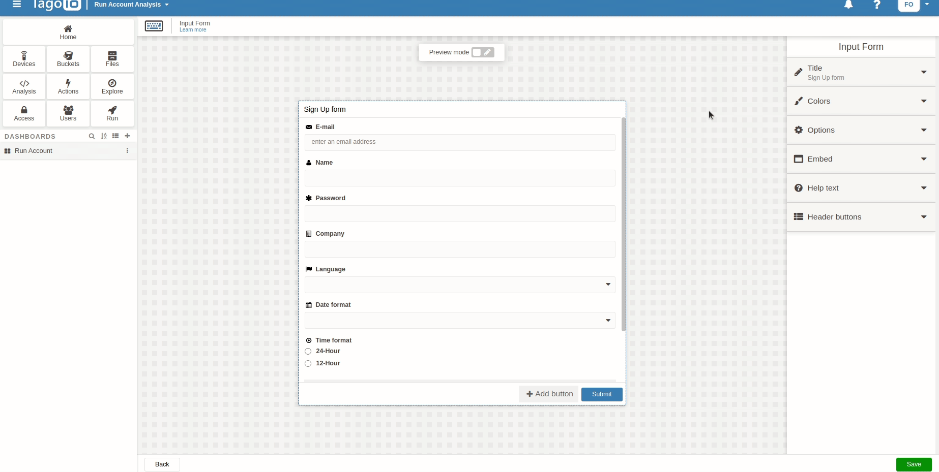

Creating the Input Form
The input form will take the user’s data information and trigger the analysis so it can create the account. First of all, we need to add the required fields described here (email, name, password); all other fields are optional when creating an account, but for this tutorial we are going to add fields for the company, language, date and time format.
The timezone is also a required field but was fixed in the Analysis code, and you are able to adapt it as you wish
CreatingInputForm
Start to create the email field, and it should look something like this, with the single option checked.

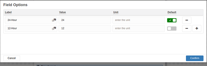

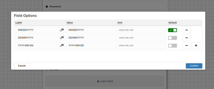

Then create the others: name (text field), password (password field), and company (text field). For the dropdown fields like language, date format, and time format, you have to give options that are accepted by TagoIO. You can not include a date format that we don’t have the option for. Because of that, I suggest you use the following options:
Language dropdown field
Date format dropdown field
Time format dropdown field

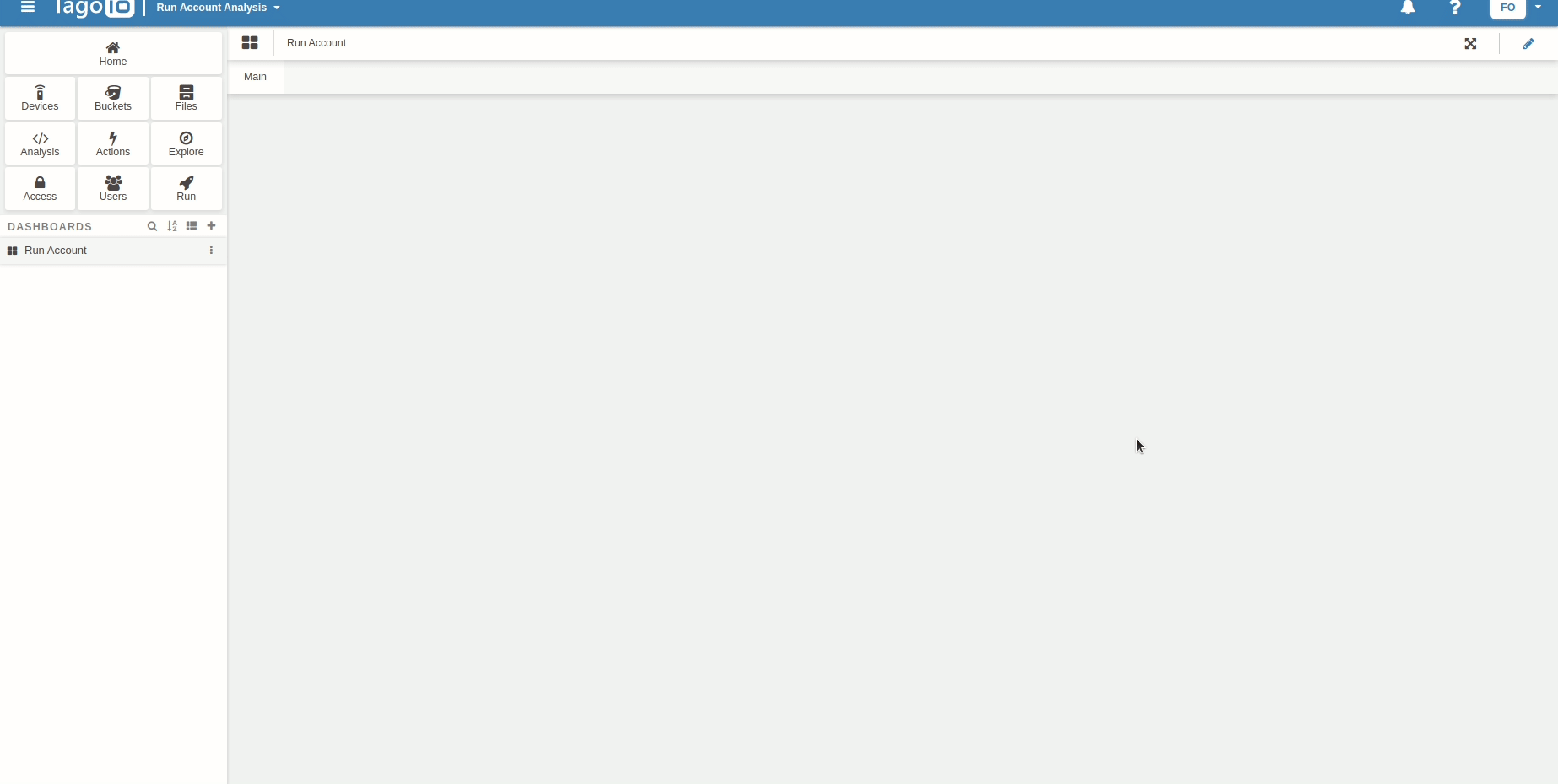

After creating the fields, you have to configure the submit button so it doesn’t send this data to the bucket and trigger our analysis created earlier.
creatinInputFormSubmit
Now that everything is successfully created, you can check that when you submit the form with at least the required fields filled out, a new run user will be created in the User Management menu. This input form can also be embedded, and you can use it on your website.
