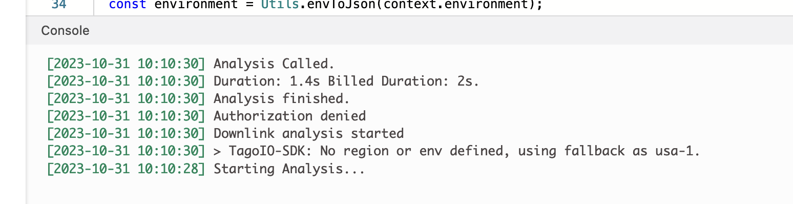

Hi, im having the same problem, follower everything from the link you provided but im recieving autorhization denied and i cant send downlink from dashboard.

Can you show us the analysis error you are receiving?
This is what i’m getting. My current setup is having 5 devices connected to tago.io all of them are class C devices, and im recieving uplinks normally but i cant use the analysis to send downlinks to them, i followed all the tutorials that tago io offers.
i have created the profile token and place as environment variable inside analysis with the key as account_token, i followed exactly the tutorial from https://docs.tago.io/en/articles/221-downlinks-using-dashboards and yet im recieving authorization denied. I already set the policy as the tutorial demands for my current analysis.
