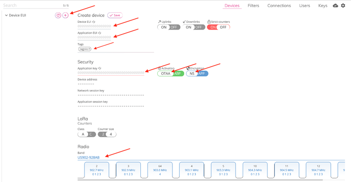

Now, make sure you have the keys for your device that is shipped with it (image below), and go to your account at Everynet.
At the Everynet portal, create a device following by enter the keys and the selections shown below. Make sure you select the right Radio band of your gateway. Here in the US, I picked the US902-928AB.

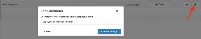

One last setup step: if you just created your first Authorization, you will need to update your Authorization advanced fields at TagoIO using the Connection ID above.
To do so, just go to your account at TagoIO, under Devices/Authorization, and update the field. Edit the Authorization that you created for Everynet and enter the fields: region;connection_ID. The most common regions are eu , us , and atc . Paste the connection ID from your Everynet account.

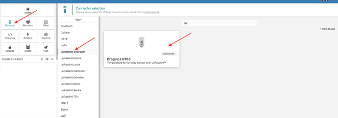

Now, you just need to Add the Device in your TagoIO account.
Go to Devices/Everynet/LGT92. Enter a name for the device and the EUI - you can use the QR code to capture the EUI !

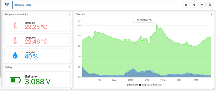

Below is the screenshot of my dashboard with real data.
